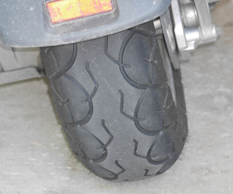

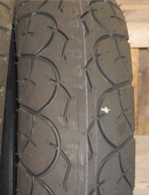

The Shinko was at 41 cold the first PA run two weeks ago and it stepped out a bit in the twists.
I was taking it easy in the twists this time with only the front brake to rely on but the front stayed nicely on line tho I missed having the rear to work with. Was interesting practice and sure pointed out how useful the rear brake is especially at low speed.
For reference.
New Shinko ( bought a spare )
Have ridden this about 6,000 km
Kids - sport bike tire.
White Burgman 650 standard
