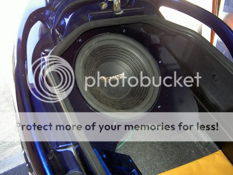

I've seen many speaker installs on the 650 - I've yet to see one that I would be able to live with on my 650. A decent helmet speaker set would be my first choice. I'm still looking for a setup that I could justify cutting up the top box for. Maybe there's a mono radio in my future - there isn't enough room for stereo speakers unless I mount something like a sound bar to it.

Actually, the real problem was pointed out by Liam: at speed, you just cannot hear them over the wind noise!
And this particular installation (clean though it is) puts the speakers in the space that will be occupied by the mirrors when they fold in. This can be problematic on an Exec with the power mirrors, or for anyone who has a need to swing them back. The upper glove boxes are probably the best place to put speakers if you absolutely insist on doing so. In-helmet speakers (or earphones) are a much more effective solution -- and can be remarkably inexpensive if you do it yourself.
How? Get a cheap set of headphones with wires that don't go through the headband, cut away the headband and velcro the headphone pieces into your helmet. Route the wires through under the helmet padding, gently tie off a loop of the wire around the chin-strap so the speakers don't get pulled out by the cord, and you're done. Add a headphone extension cord to reach the handlebars (or wherever) if needed.
