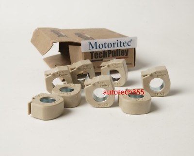

They have tabs to prevent them from "flipping" which apparently happens in rare instances. They are similar to DP sliders but I don't know that anyone has done a direct comparison to see if there's any size (gearing) difference. They're not as common as the DP but I don't recall reading any complaints about them.

I have a nice new box of them at home. have not had a chance to use mine as the engine is kaput. in due time I will.
Some have said a slider of theirs have flipped, not sure of that. The Tech pulley/flying rollor brand slider have an extra lip on top to hold it in place. I would buy that or Dr P, it wouldnt matter. Better and cheaper than oem rollors.
Belt, oem is best.

I used the 19 grams and have not had any problems in about 6500 miles. My 400 is pretty quick off the line but will not go over 85 mph which is not an issue for me. The tach also will not go in the red as it does with the stock rollers.

Regarding rollers for a 07 an400.... has anyone experienced these I found on eBay??
hello guys, could anyone tell me what maximum speed with pulley rollers 16g, on an 400?
1,586 Posts
16 gm rollers (or sliders) won't reduce your top speed. That would only happen if they didn't go fully out on the ramps. If I recall, when I had 16 gm rollers the rpm matched stock at around 55 mph. Below that the rpm was higher than stock rollers, similar to around 18 gm sliders. (That's with the stock contra spring - change that and there results will differ.)

I installed these along with a new Malossi belt in my 2008 400 at 17,500 miles. I like them. Much smoother around town. I dropped highway cruising rpms by about 1k as well. Not sure if they had any effect on my top speed, but at 1,000 miles on them, I'm glad I did it.

I went ahead and ordered a set. I guess I'll find out this spring. Recovery??? Well.... going slow but good. Old man just don't heal as fast as I use to.... HA!
Better highway speed with lower RPM is what I'm after. Not so worried about the hole shot. As is, 70MPH has the tach just past 7,000.

I’m with you. My 07 400‘s tach seems to match my speed according to my GPS. 7k=70mph, 7.5k=75, etc. Most of my riding is city but I want to be able to enjoy some interstate riding without my engine screaming in my ears.
Finding a recommendation for the best slider weights is similar to searching for opinions on which oil is best. 😉
One question I can’t get past is, if sliders are better, why do manufacturers use rollers?
1,586 Posts
I would say slider weight selection is more of a subjective choice than oil. There can theoretically be a "best" oil, it's just that there is virtually no objective way for most people to evaluate it, and therefore it becomes an argument of opinions.
Every person is different when it comes to gearing selection, and every choice has trade-offs. For me, I think the stock rollers get it roughly backwards...eg low rpm accelerating at low speeds and high rpm at highway speeds. But that may be perfect for some others' tastes. I like the higher rpm on take-off and more relaxed rpm at cruising that sliders offer. As to why manufacturers don't use sliders...probably a complicated answer with many reasons, but maybe partially "because we've always done it that way and it has worked well", or maybe that gearing profile is exactly what they're after because they think the majority of buyers want it.
