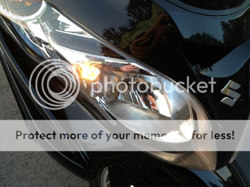

So just a few questions I haven't been able to find answers to on the forum, I keep noticing that these lights seem to stay on sometimes after I walk away from the bike just after turning it off from a ride, or often they will be on when I am walking out to the bike in the afternoon. Now the battery has never been dead so I can't think they were on all day while I was work so my question is this, does the bike turn these on when you get near it with the key as a courtesy feature? I wish I had an owners manual, but didn't get one with the bike. Just those two little bulbs are all that ever stays on after I walk away, they turn off after a minute or two it seems after removing the key and locking the ignition.

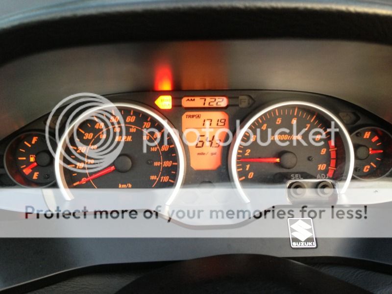

Now second question, I read the fuel tank is about 4 gallons, so is the bottom of the gauge orange area the real empty mark, or the start of it?

Oh I found the answer to my question about the lights just now, I see there is a second position for the key that's causing it so I one mystery figured out.

It's a wonder that you did not run your battery down with the parking lights on (you must have a good battery). ;)
I felt special for a minute to, thought maybe it knows when your close to it with key and lights up just for me ;)

I did extensive research :rolleyes: into the gas tank quantity vs. the gauge reading many months ago. And posted results on this site.
There is a lot of gas in the red zone. I don't remember the miles I traveled before it ran out of gas though.

It's 3.5 gallons. When I had my 400 it took a while for the needle to move off of the full mark but when it did it went south quick. If I remember correctly I had about 1 gallon left at that mark.

I find according to mileage that from above full to full is about a gallon, from full to almost empty is another gallon, from almost empty to the bottom of the red is another gallon, and from the bottom of the red to empty is the last half gallon.

That's pretty much how the one on my 06 works too. When the top of the needle is just touching the bottom of the red it takes 3 gallons to fill the tank. That says I have about 1/2 gallon left in the tank.
